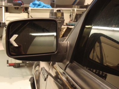

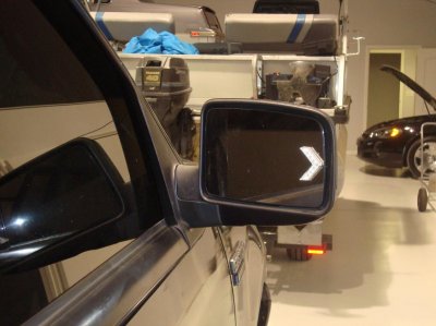

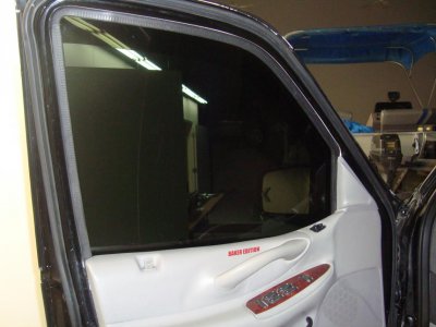

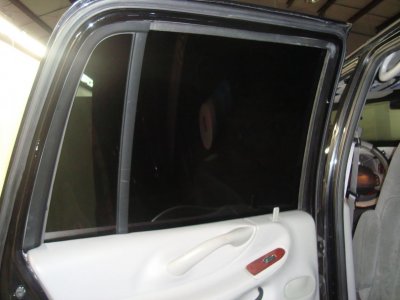

Got them hooked up today...what a job...what was I thinking?????? drivers side was a B&%ch with the E brake in the way...so I got them all hooked up and tested them and everything works great...till I went to pull it out of the shop....and when I hit the brake pedal both arrow lights, light up...I used a test light and checked my wires...so I'm done for tonight...ALSO....I got the mysterious inop dome light issue solved and saved my self 75.00 trip to the dealer.....while I had the door panels off I was looking around and found that someone snipped the ground wire in the door harness...hooked it back together and WA-LAA got courtesy lights...got a couple of shots of the new window tint as well....also put a new radio antenna on The Shark...powered amplified....works great.

was wondering how those went on your mirrors. to be honest not a fan. but good job hooking them up and figuring out your dome lights. btw like the baker edition on the inside of the door. nice touch.

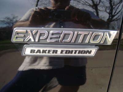

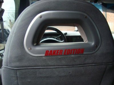

Talls, they have thin 2 sided tape and stick to the mirror...then had to rap the wires inside and feed them through...was eaiser just to remove the mirrors and do that on a the bench...I placed the Baker Edition logos in a few other spots...I had a guy ask me one day if the truck was specially built for me...and I said SURE.....made me feel like a big shot for 30 seconds...LMAO...

Doing this mod the "Thermo Way", I would have simply ran a strip of LEDs along the gap between the mirror and the outside edge of the mirror housing. Sure, a little more work, but it would have looked a little bit cleaner, especially if you would have coated 5 of the 6 sides of the LEDs in black paint. That would have caused the LEDs to blend in with the black plastic of the mirror. But, too late now.

Lookin good! Is that the carbon tint you got a while back?
Yes, I finally just had it installed this past saturday..guy did a great job and boy is it dark inside...I dont know if im gonna like how dark the front doors are...livin out here in po-dunk you cant see nuttin...but it looks great....thanks for the compliments burch.....as far as the turn signals...everyone has there own way and thats what makes us a group have some of the most unique vehicles...
