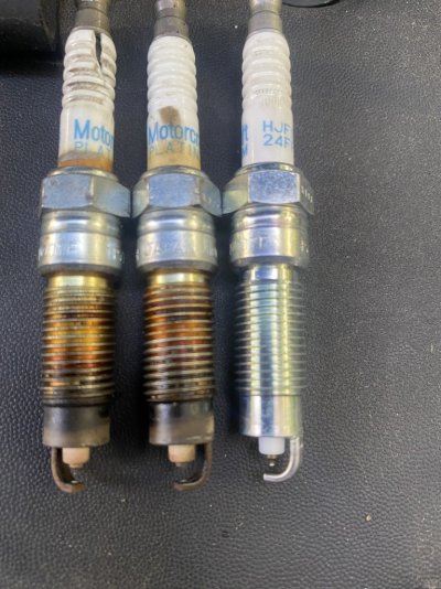

2x_tom
Aug 21, 2022
Pulled #5(left) and #8 (right) so far. I guess they are original plugs and had to be done either way.
