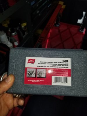

Would be a smart move to have this tool beside you incase any do decide to break.
