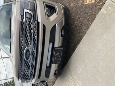

LGE-CTS make a custom grill insert light bar
https://www.lge-cts.com/shop/lighting/off-road-lighting-kits/front-bumper-light-bar-bracket/
Several members have a light bar behind the grill

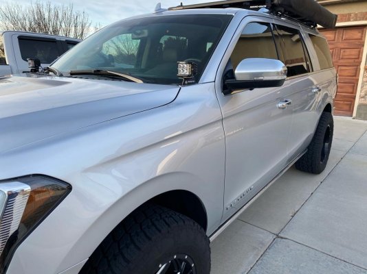

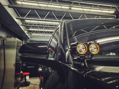

I have the SDHQ A-pillar brackets. No drilling required.

Curious why you can't mount them at the a pillar? Worried about knocking them when brushing snow off? The Flex lights are quite low profile...

As a Navi owner I'm super jealous of your bumper design. It's got a slit perfect for an LED bar. I'd hold the visionX for if you get a bumper later or roof rack... Too many decent cheap led bars out there now a days. Would be quieter, not dangling off the nose and would be protected from snow inside the bumper. Might get some build up if you are following somebody but that applies to lights out front too.
