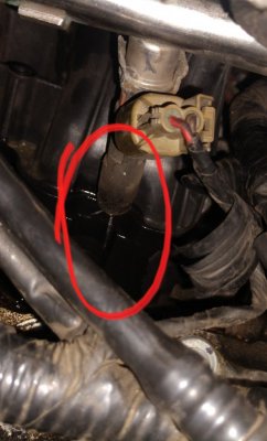

I would say it is leaking a little

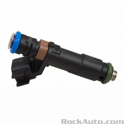

Yeah, I think you found at least one of your problems. How do the rest of them look on that side ? Or you may just want to replace all of them and be done with it. You can get Motorcraft CM-5138 injectors from Rock Auto for about $30 apiece.
https://www.rockauto.com/en/catalog...5.4l+v8,1433355,fuel+&+air,fuel+injector,6224
The other 7 are holding fine. But I decided to bite the bullet and replace all injectors, plugs and coils packs since it has not been done in the time in have owned the car (6 years) and possibly not at all. Everything should be here this weekend. I have all 8 plugs soaking in pb blaster and will try to pull them tomorrow. Keeping my fingers crossed.
