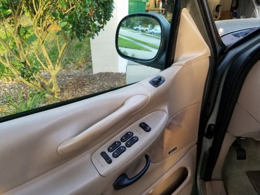

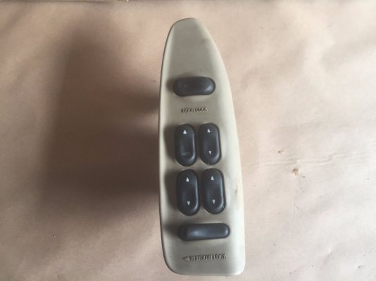

CHECK YOUR GEM MODULE IT MAY HAVE GONE BAD OR GOT WET IT IS THE BLACK BOX LOCATED ON TOP OF THE FUSE BLOCK BUT IF ITS BAD YOU WILL HAVE TO GO TO THE DEALER TO GET ONE AND HAVE IT PROGRAMMED PROPERLY. SOME COMPANIES SELL THEM BUT THEY ARE NOT PROGRAMMED CORRECTLY TRUST ME I LEARNED THE HARD WAYI have no power to my mirrors...or they aren't working. The switch does nothing and they were both working when I bought the truck about a month ago. Also my driver rear vent window is not working and I don't hear any sound out of it. I bought a new motor for it, but with all this other stuff going on, I am waiting to change it. The left passenger side opened today but wouldn't close until I turned off the truck and started it again. The rear wiper stopped working again. I changed the motor last week and it worked fine until the other day. Now I don't even hear it trying to run. All my windows go up and down fine from the master switch housing in the driver door. I checked the fuses and they all look good.
Any ideas? Anyone in Central Florida good at this stuff willing to help me out for a couple cases of beer?
I don't want to buy new mirrors to come and find out they still don't have power. The vent windows aren't crazy important, but I have them and would like them to work. The rear wiper is fairly important to me I suppose. I don't use it often, but living in Florida, it would be nice to have.
