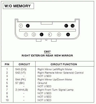

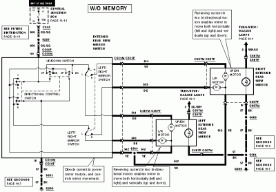

Look at the prints C511
Disconnect the connector for the Switch Then take your voltmeter and read the voltage between pin 1 and pin 5 on that connector
Post the results
