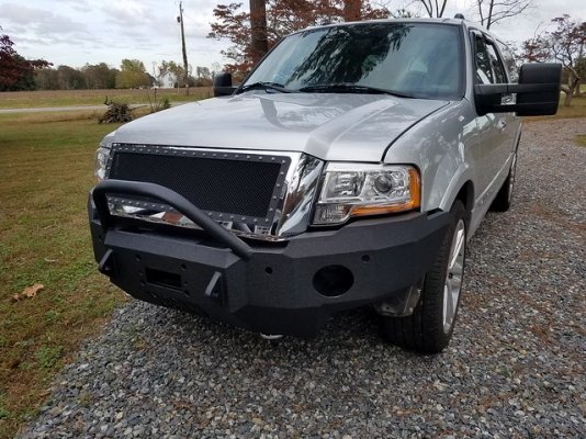

Let me know how it goes with the grill. I have a thread going about it. Here's where I am with mine. It's just set in place. The grill is an 07-14 obviously and my Ex is a 17. I think I'm going to need to modify it slightly though.
Don't forget. We're picture ******! Didn't happen if you didn't take a pic lol

Is it my imagination or is the grill not vertical?
One thing that I need to mention is that my shredder opinion for the bumper makes headlamp removal impossible.
It's just laying in there right now. Even the bumper just has two bolts holding it up. It doesn't look like the bumper I got is going to be in the way of anything luckily. I don't know how the parking sensors mount though. There's just holes drilled in the bumper where they mount.

Okay, that makes sense. I was wondering if it was an off-road issue, i.e., easier manipulation of the throttle. I can’t imagine having 4.56s, even with 4.10s I would struggle with spinning the tires everywhere I went. Even with my 35s, I have constant TC light flickering while I’m driving. Lol

@HawkX66 you have to glue the bracket to the bumper. Make sure you have a good way to clamp it on so that the sensors are centered and not recessed. Otherwise you might be getting false readings.
