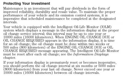

Sounds like FORD is all over the map on oil changes. In the Owners Manual they specify a few different recc oil types to use ... and recent news is they changed the viscosity to use. (but I never got a letter)? The Owners manual is all over the map on oil changes, but some lawyer threw in the 5000 number in there somewhere as CYA, just never go past 10,000? Its BS. If FORD timing chains cant handle 6000 mile oil change interval then the Engineers and Accountants at Ford suck DD and should go find a new job.
Can you point out the "recent news" and where the oil changes are "all over the map" in the owners manual? The info from the owners manual you posted contradicts much of this.
Change the oil whenever the computer directs isn't confusing. 5W-30 synthetic blend or 5W-30 full synthetic ain't confusing either (to me).

Your dealer is full of it. Of course they are covering it under warranty, they can blame it on your oil change interval all they want, but considering Ford does NOT have a mileage-specific oil change interval unless it doesn’t get reset properly, what possible reason could they give for denying a warranty claim based on the oil change interval Ford recommends? Could this be to cover up the fact that they replaced a turbo for absolutely no reason because they said it was “rusty”? Which basically isn’t even possible on these turbos as nearly all the parts are made of material that doesn’t rust? Your dealer screwed up, and it’s easier to blame it on you and your maintenance habits than it is to accept responsibility for their mistake in not diagnosing it correctly the first time. Any claim they have to knowing about the EcoBoost was lost as soon as they showed their ignorance by blaming a rusty turbo.
There isn’t any variation on the issue of oil change interval. The 2011-18 manuals all say the same thing: change when the computer says to using 5W-30 synthetic or synthetic blend. Ford has never made recommendations to either change the interval of the oil type.
The 5K miles number is due to that being the earliest the computer will tell you to do an oil change based on usage. The 10K miles is the longest it will go. It came from the engineers, not the lawyers.
If you want to change it sooner, have at it. You aren’t wrong. I have 65K miles on a truck with 6 oil changes and my wife has 85K miles on a truck with 8. I’ve read enough about the EB to firmly believe the odds of overly long intervals causing an issue to be small.
The EcoBoost timing chain issue and matching TSB was issued for 2011-14 engines. They revised the timing chain and tensioner design with the update for the 15 F-150 they did. This is the design our trucks have, and I haven’t seen a ton of complaints about timing chains on the 15+ engines. Doesn’t mean it can’t happen, but everything has a chance of failure. The issue on the earlier engines may not have been as widespread as you’d believe based upon reading forums. You naturally hear about the failures, but extrapolating the total number of failures versus total number of engines is nearly impossible. I wouldn’t live in fear my EB is going to come apart unexpectedly some day.
-- Chuck
The recent news was from JE07 on a post that you read and posted on several times, maybe you missed his post? He said "We are now finding out down the road some of the issue is Ford used 5W-20 weight oil in the U.S market for CAFE reasons over VCT component reliability......now they are telling us to switch to heavier oil." Of course, I have not seen the official communication from Ford. I believe everything I read on the internet.
The (2015) Owners Manual specifies two types of oil to use. Both synthetic, I thought it said 3 & included normal oil so you're a lot more right than me on that. I wonder what manual I read that in? My 2014 with 5.4 has different specifications.
I'm an Engineer and think a consistent "use this type of oil & change it after this many miles", where the type of oil used didnt change after a few years ... would be a little more stable. However, I reread the documentation and can appreciate the different types of driving that is possible with different oil requirements.
I use the on board oil monitor myself, never said that was confusing.
