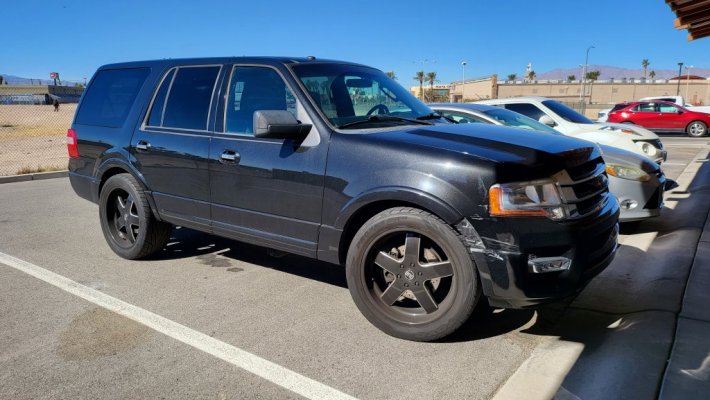

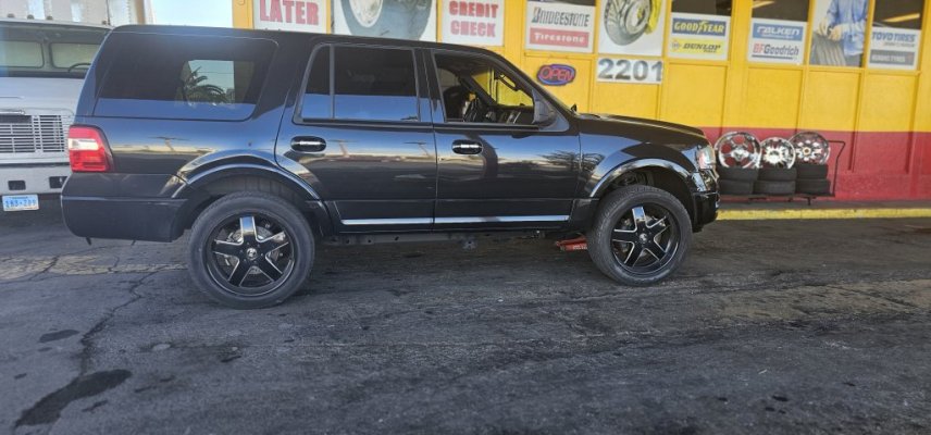

Before running the best setup to date:
Front: Belltech shocks with no spacer rings installed. Also, installed Hellwig front swaybar.
Side note, I did use F-150 front shock assembly when I went back to stock. So, its F150 spring on the belltech shock now.
Rear: 03-06 Belltech lowering springs.
Still searching for a way to get the rear lower. Might cut 1 coil.
No rubbing anywhere. Handles amazing for a big brick.

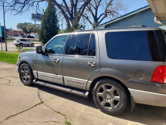

I lowered my 03 4WD with the Belltech 929 kit and Bilstein shocks. I thought the springs looked identical to the springs on my 2010 as well. Did you try the front Belltech springs at all before the F150 assemblies? I hesitated lowering my 2010 because of the Houston flooding but after getting caught in my 03 and tackling it flawlessly, I said screw it and want to go ahead and do it.

Stock in front maybe? To level it out. Definitely looks good though
Thanks. Thought about adding 1 spacer to bring the front up but I am way too lazy for that haha. But after driving for a while, love the look and how she handles being that low. Im 90% sure im cutting the rear springs to bring dat a** down.

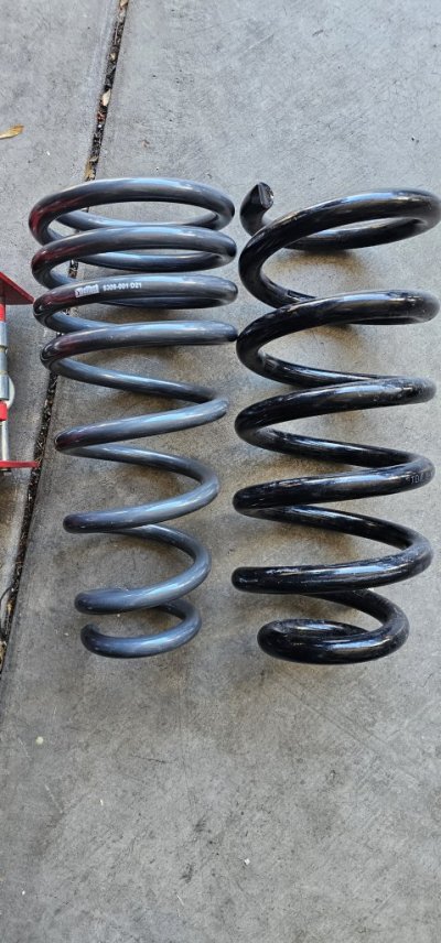

I did use 2003-2006 Belltech Springs to lower the rear:
