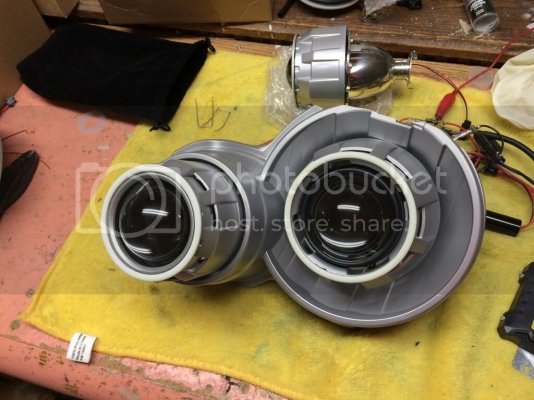

Well this is my attempt on my Double projection lights with Halos..

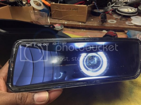

They are both Bi-HID's which let me do either single low beam or double low beam as well as single hi beam or double... the output is insane so I had to re adjust the beam to aim much lower than normal... Dont want to blind people thats for sure... Now I'm working on the fogs

Those came out great. What projectors/hid kits did you use.?
and did you take any pics as you did it?

Id love to see the during pics if you dont mind posting them, to see how much you cut, wire routes, etc.
Very little cutting most of the cutting was on the hi n low beam bowls to fit the back end of the projector beams. Wiring is all inside the housing.

Dude those are so mean looking, I love the way those fogs look awesome job.
Are the fogs morimoto's also?
