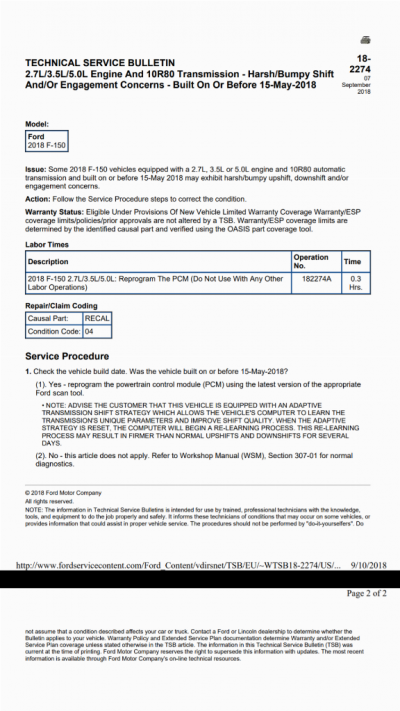

So last night we were headed out to dinner and went ahead and threw it in sport mode being I prefer that feel.
I immediately felt something was "off". When shifting up and when around 4th gear I detected an unrecognized clunk feel through the pedal. It would do 4-5 clunks as if it was struggling to engage a gear and the cluster showed same gear until the clunk went away and advanced the ratio. I was able to replicate the feeling after every red light. This was with very light throttle input and the fluids were all at temp so there was zero chance of a gear slipping causing this. Yet would be more described as what's known as a gear hunt.
Got to first destination which was gas station turned it off, filled it up, turned back on and all went away even with putting it back to sport mode.

The interesting thing is the TCM should have what' known as a quicklearn function which is a process where it expedites the learning sequence following a reflash.
It's ******** Ford isn't having their techs do this being the most dangerous thing to do on an adaptive memory transmission is to just flash it and send back in to normal use.

Anytime the PCM loses power, like during a reflash or a battery swap where backup power is not applied, the system defaults to a baseline setting and adapts from there. The baseline settings are probably fairly close to ideal for the majority of drivers, with the fine tuning to compensate for those that baby or leadfoot. The initial learning is fairly quick with the fine tuning taking more time. The reflash is probably easier on the transmission than having two drivers with completely different driving styles share the vehicle. What I wonder is if the system has to learn a separate strategy in every driving mode. In the 5R110 in my truck, anytime I change the power setting on the module or even when I tow the fifth-wheel, I will pull the PCM keep alive fuse and let the transmission relearn. It adapts faster that way without all the ugly behavior.

From the tuners I've talked with, the learning is 250 miles following flash on average
