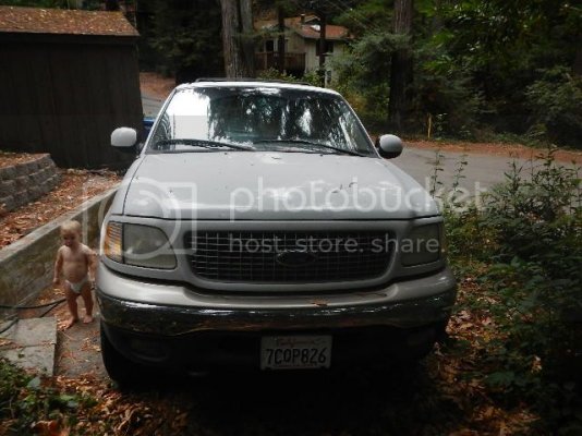

Hey all! New to this forum and just bought my first Ford in about 10 years. I'm a Subaru guy mostly but Subaru doesn't make anything big with and 8 cylinder motor so for times when more muscle is called for, I just bought this.
$400. project. (My little apprentice is standing next to it looking for sticks and talking about daddys "big truck") 161k with AWD/4WD and eddie bauer package/ towing. No surprise that it needs a few things. I'll be getting it ready for some light towing and such. Any insight and knowledge is appreciated on the following issues.
