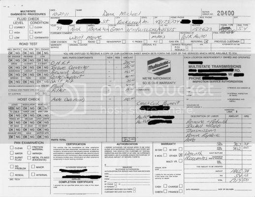

when the tech finished installing the trans. he of course tested it, the front driver wheel would bind while freewheeling on the lift, so they pulled off the front Differential cover and inspected the innards all of which checked out.
that led the tech to the conclusion that the drivers side axle was shot, called the warranty comp., covered!!
for anyone who may need to go through something similar this is a 99 exp. E.B. with the 4R100 Transmission,
the bill reads as follows: (I'll post up the bill later after I scan it and blackout some info)
Overhaul kit $245.00
Torque Converter $295.00
Forward Drum $110.00
Center Support $41.00
Shift Kit $39.00
Fluid $43.00
Filter $19.00
Axle (D/S front) $110.00
Parts total $902.00
labor total $963.38
tax $54.12
Total $1,919.50

the warranty company is called ASC Warranty. P.O. Box 2400 Mountain Home, AR 72654-2400 1-800-264-5090 online entry avail at ...ascwarranty... it's a website, and I don't want to break any rules, surely you can figure it out...
Labor is included in all plans offered, you also get 24hr roadside service. best thing I ever bought.
Here's the receipt I promised everyone.

ROFL, that wasn't my credit card. remember I payed NOTHING.
and that's no bull. the truck broke so I parked it, called a friend who referred me to multistate. (Jay)
Jay said he would tow it for free since he was doing the work, the warranty company covered the parts and labor 100%. I picked up the truck exactly 7 days later almost to the hour it broke down.
I guess that credit card was what ASC used to pay my bill. so they really don't screw around, when they say you're covered....they mean it.

and both times the full charge was covered, even the extra stuff like filters, shift kits, and labor. (and I know for a fact at the labor cost on the pic above that he charged them overtime)
and ASC even sent a real person to the shop to personally OK the rebuild (which is why it took 7 days instead of 5...3 if you take out the weekend)
