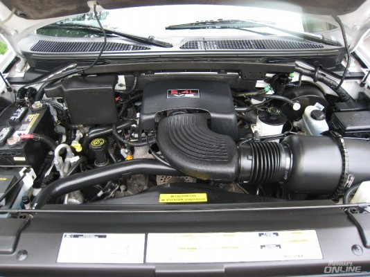

Yes I know that - but my issue is that all documentation says 226 kW (which is roughly 300 PH) - and VIN says 5.4 2v (L) - so I'm confused. I know that my car left the factory in Michigan with 5.4 2v.. But providing that if the documents are good, that means the engine was swapped with the younger one. But have no evidence. And the only way for me to know is to physically check. That's why I'm asking about any characteristic points, that differs 2v from 4v...

Yes :):) It looks like mine (except for that plastic cover with 5.4 inscription on it - it is missing from my engine). But the air filter and air intake looks like in my Nav. I suppose in 32v there is different intake/filter housing than on this image?
