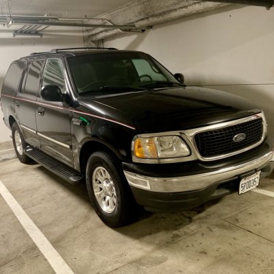

‘01 Expedition “Big Daddy” 2WD 5.4 Oxford/ Medium Parchment totaled by distracted driver (T-Bone red light, T5-T6 bulging disc)
‘02 Expedition “Mr. Big” 2WD 5.4 Oxford/ Medium Parchment totaled by elderly woman trying to park (bless her heart)
It’s been hard but I was blessed with an ‘02 4.6 2WD Black/ Dark Graphite. The difference is that the first 2 were mistreated and had questionable pasts whereas this one was one driver garage kept by a housekeeper, then retired gentleman before myself.
I’m 35, my friends and coworkers make fun of me for this, but I want to keep everything original spec. I replaced the 16s with the 17s when I bought it because the tires were bald and the sticker specified 17s. He should have the 17s.
That being said, the 17s it has are 265 70 17 but the sticker says 275 60 17. On the second (“Mr. Big”) Expedition I had the chrome 17s with that 275 size Coopers that were very wide and Goodyear RS-A that were almost too small but oh so comfortable.

Technically it's a 275/65r17 if you want it exactly the same. That being said, you can go up to a 275/70, or 285/60, and they'll all clear. I'm a believer in keeping the gears, the speedo the same, others will argue, and say this and that will work. Bottom line you mount a tire one front, one rear turn steering wheel, check clearance back by a quarter panel for clearance. Worse thing is having a tire rub for 30,000 miles. Happened to me on my old 56 VW bug, way back in the Disco days, when I went from a scrawny 165sr15 to a 185/70r15 and new chrome wheels. Luckily it was minimal. Now if I went with a 65 or 60 profile, probably wouldn't have scraped at all.

Thanks for the feedback. I’m looking to get him back to OEM/ Security or at least Police spec.

OMG, she's a beauty. Looks like my 02 but in MUCH better shape. If you ever want to sell, let me know, lol.

I have the same rims. My door spec is 265/70/17. That truck, looks like its in nice shape. I would Keep those Goodyears. I think the white letters, look better, however.
