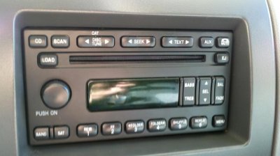

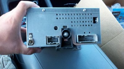

okay, 2006 expy with factory 6 disc changer, no steering wheel controls, no navi, no dvd, no subwoofer. i want to install a JVC KW-AV61BT. took the factory radio out and found 2 plugs the big rectangular one i know is for power and speakers. the other smaller recangular one i have no idea and the wiring kit does not have that plug on it just the one for the subwoofer which is not on the factory radio. ive searched google and cannot find out what the smaller wire set is for. please help with some insight on what that other plug is. do i even need it? first pic is front of factory radio and 2nd pic is back of it. i have the metra 70-552 wiring kit, is this even the right one? please help, i couldnt sleep last night.lol

the smaller of the 2 plugs is the imput for the changer. To my knowledge no one makes an interface/adapter/plug to retain the changer. If you had a stock subwoofer there would be an even smaller plug to the right of the antenna jack.

ok got it. stopped by an audio store and asked they didnt know what it was for also so they told me just to try it without it. low and behold it works. thanks guys.
