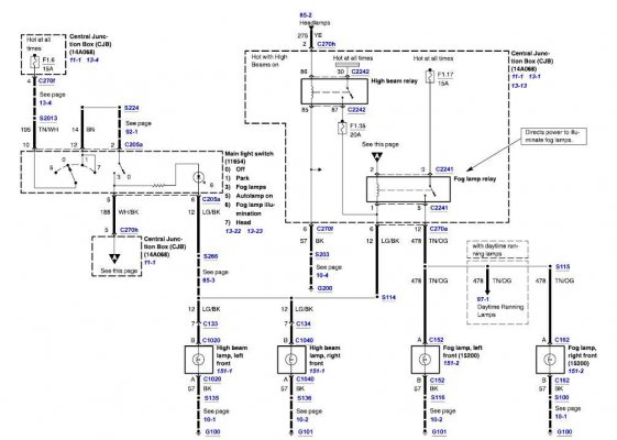

I had a new light switch installed by the dealer. They left several wires loose (not connected to anything).
I need to know the color of the hot wire to the fog lights. Mine have not worked since that "install", and I want to have them working.
Any good information will be greatly appreciated.
