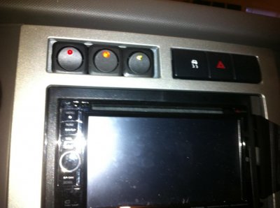

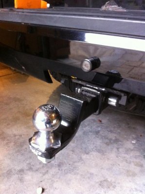

Here are a couple pics so far
KC slimlites
Rear view Camera
MY idea for a sub in the rear panel
the switches I found for the dash that are a perfect fit

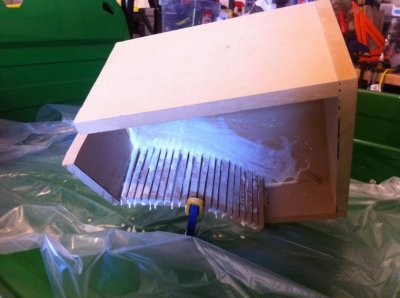

Working on a "stealth" box that will fit in the rear panel.
It's under the 1 cu foot of air volume that they suggest for a closed box, but I think it'll sound fine.
Sorry, got a bit messy with the glue trying to strengthen up the rounded piece that rides the wheel well...
