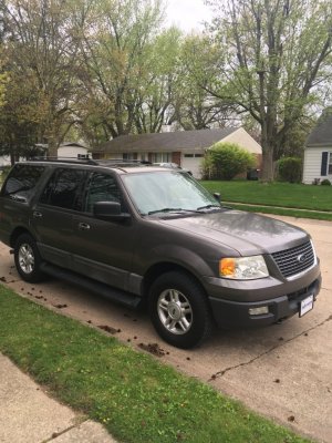

What's up Expedition Forum,
I just picked up my used '04 Expedition XLT after a pretty long search for a second vehicle for camping trips and tailgating. I had looked at several tahoes, suburbans, and expeditions and settled on the expedition because on a vehicle to vehicle comparison, it by far ran the best and had the most extensive service records of any I could find (regular oil changes especially after 100k). It also had only 148k miles and one of the last production 2v 5.4. I was trying to avoid early model 3v 5.4's.
Overall, I am pretty happy with the car and especially what I paid for it. With that being said, I have it in the shop now to fix some things I noticed when buying it. I definitely have a few questions for the forum on their experience with these issues and what to expect
1. It has a pinion seal leak. (I've read this to be pretty common around 150k)
2. It has some valve cover gasket leaks (Again pretty common for mileage and age I hope)
3. It needed new brake pads (Regular wear and tear.)
4. I'm debating switching to 5w30 on this engine. I know its common on the 3v 5.4. Anybody run 5w30 on their 2v? I do live in northern Indiana and winters can be cold and brutal.
5. I've also noticed some "pudding" on the oil cap after short trips. Pulled the dipstick and the oil was clean and no sign of a coolant leak. Looking down into the fill spout it looked clean as well. I know this can be condensation and perhaps mean a new PCV valve is needed.
Other than that the tranny fluid looked clean and it runs and drives like a champ. As it is an older used car, I am not looking for 10 more years, but hopefully a few more and to make it to 200k and few good road trips. Any words of wisdom to help me get there are much appreciated.

Welcome! Nice color. I'm down in Brownsburg myself

I was in the same boat as you selection wise, there aren't many around here w decent miles and condition. I see the front plate in the pic did you get that here in Brownsburg? I know Estes has many lots but the big Ford one is a few minutes from my house. If so nice find, I missed that one. I picked up an 03 navigator about 2 weeks ago and was also looking at expeditions but couldn't find much in indy area that wasnt either overpriced, a 3v, or in awful shape body/interior wise.
