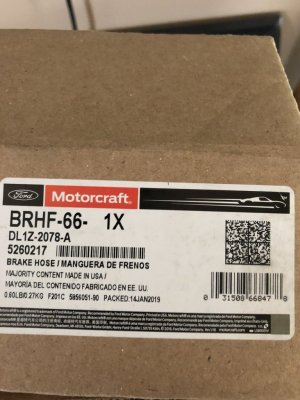

I’m replacing the hydraulic hose on the passenger side of my truck and it keeps trying to cross thread by hand. The threads won’t line up from the steel line to the rubber hose no matter what. Anyone have this issue? I undid all the mount and it still won’t go.
6,530
3,140
Ready to put the old collapsed hose back in. Buyer beware the new Ford hoses are threaded incorrectly.

1/8” National Pipe thread works ok. Run it in about 2 threads and then the line will clean up the rest for you and hit the flare and seal. Don’t worry about using a tapered thread dye, that’s not the seal anyway it relies on the flare. All done.
Here is the part # for passenger side.

I had the same problem with threads, same part number and had to put the old hose back. Wasted hours. Then I found a set of brake hose fitting tap and dies on ebay. Made the job a snap. I thought I was the only one with the bad threads!
