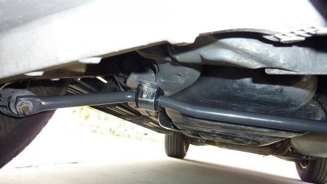

I had the Bilstein HD's on mine for about 75k miles. The Bilsteins combined with the stock springs gave the best ride, and handling was equal to stock new. If you don't want to bother breaking down the shock/spring assembly for that installation then I would recommend the KYB Strut Plus setup (my current shocks). The KYB's have a stiffer spring rate and will give you more of a 1/2 ton truck ride, which might be helpful for towing your trailer, depending on it's size and weight. The biggest improvement in handling came with the installation of the Belltech 5550 rear sway-bar. The heavy duty sway-bar also helps the handling during towing of my boat, even though it's only 2,000 lbs.
Belltech 5550 Rear Sway Bar .....

I took a look at the stock sway bar. It's pretty puny. I put a beefier sway bar on my son's Jeep Grand Cherokee - but it was mounted more toward the rear bumper. The one on the Expedition is forward of the rear tires. Did you have to put your Expedition on a lift to get to it (safely)?

No, I just did it there sitting in the driveway. The Belltech comes with polyurethane mount bushings with grease fittings.

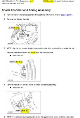

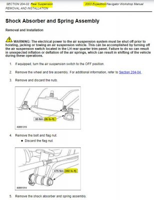

Luckily I already have torque wrenches. Speaking of torque... I found some better torque specs for my upcoming shock replacement job on this site:
https://cardiagn.com/2003-expedition-lincoln-front-suspension-4x2/
I have the service and repair manuals for all my other vehicles. But I don't have one for the Expedition. So the info I located on-line from cardiagn.com is helpful to me because it has some basic pictures :)
1 Front Torque Specs.jpg 2 Front Shocks.jpg 3 Rear Torque Specs.jpg 4 Rear Toe Link.jpg 5 Rear Shocks.jpg

Yeah those lower shock bolts are torqued to 295 and 350 ft lbs, plus the age that they are, makes it almost essential to use an air impact on them. You'd blow a nut trying to do it with just a ratchet. The Expy will probably ride a bit stiffer than stock now with the KYBs on there. But it'll handle better too.
