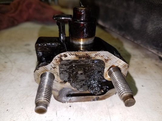

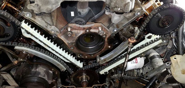

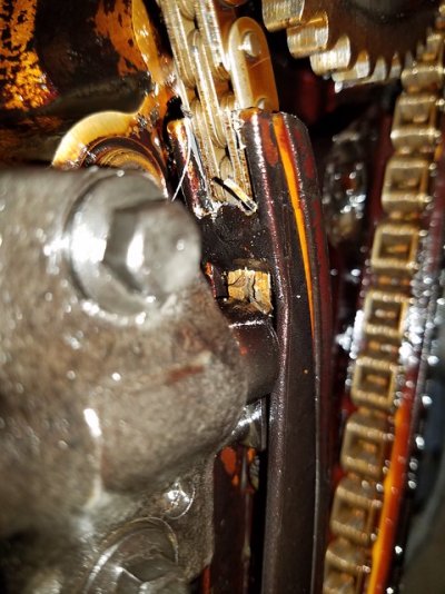

+1 I have 211k on my 5.4L. Timing chain isn't on my list of things to worry about because I change the oil. The Mustang I bought and ended up building with my son for his first car; however, is a different story lol Like these parts? Same thing, only different... We bought it this way from a girl. Rapping like Run DMC.
33258280970_6e73196fb9_z.jpg20170324_181354 by Dave H, on Flickr
32828253963_4b535331d1_z.jpg20170324_160843 by Dave H, on Flickr
33610049646_2923cb0dd8_z.jpgMustang timing chain small by Dave H, on Flickr

Trying to find a high performance car like a mustang or Camaro, that hasn't been beat like a field mule is tough. Factor in a lazy maintenance schedule, and you have usually a trashed motor. Luckily the 5.0 and 4.6 mustang motors are tough.
