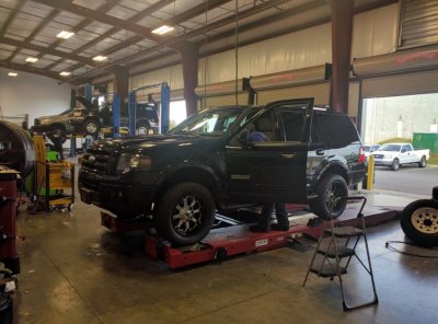

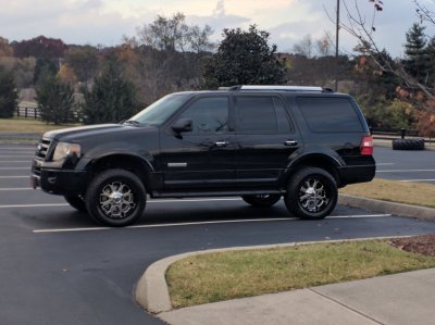

So I'm new here and have recently replaced my wife's Civic with something with a little more room. She said she wanted to sit up like my truck and have room for 7 so this is what we got. 07 expy, 3/2 lift with new rims and tires. Updated a few cosmetic issues but other than that it's a great vehicle.IMG_20171106_164512.jpg IMG_20171106_160456.jpg IMG_20171106_162316.jpg

Welcome to the Forum. That's a nice looking truck @Knox GSL. I love the lift. I've been thinking about doing that myself on my 17

Any pics of how far these wheels stick out? I'm looking for a 20x10 and not sure what offset I wanna go with. I'd Also be going with a 33" tire and have 2" of lift now. Any rubbing at all or areas that are close to rub?
