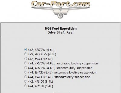

Im having the problem looking 4 a driveshaft for my 97 4x4 4.6l. I have the 4r70w buh the driveshaft i need is 42-44 inches but i look and i only find those lengths in 5.4 4x4 truckz. It makes me confused

Does your SUV have the original driveshaft? Does the front yoke fit your new trans? You could always get the 5.4 driveshaft, and swap out the front yoke and u joint. Is the rear u joint and the rest of the 5.4 shaft compatible with your rear end on your SUV ?

Ok so i finally get a driveshaft. And its like 3 or 4" off. Wat can i get to extend it or what do i do? I heard bout h yokes buh will it help?

I don't get it, is the rear end and transmission stock ford items? Unless your using custom aftermarket transmission and rear differential, their should be a stock driveshaft out there that fits. Measure from where u joint bolts up to differential, up to back of trans rear main seal, add about 3 inches that yoke goes through seal, and thats the one you need. Take your Old one with you to a wrecking yard in your area. You should find one that will work. If you want to get a new one, and don't mind spending, you can call one if the truck parts suppliers, tell the guy what you have and length you need, they should be able to hook you up.
