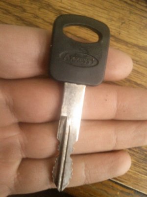

What year is your truck and how many times did you change your key?/cylinder? Can you show pics of the key and the underside of the steering column with the cover off?

I have only had one key for it the whole time its an ex cop car and dealer says there is no pats system in the vehicle

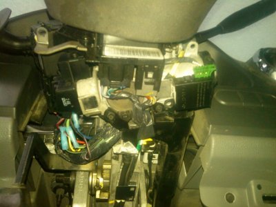

Cant tell if the pic is on there or not... there was three wires spliced into the ignition plug from an auto start i assume thinking that was the problem i cut and reconnected them to the stock wires and still nothing

Check out my posting on the forum on the Pats system. Your truck should have PATS. It should and looks like it does there is a black ring around the cylinder from what I can tell from the pic. Looks like you don't have an original ford key anymore and sounds like the key may have lost the code.

Going back to your post Dec 16, 2016 at 6:42 PM there were three wires spliced into the ignition plug from an auto start you cut and reconnected them to the stock wires. They should have spliced into more than three wires. If you got a self piercing test light double check you new connections and these other wires to make sure they are ok.
12volts yellow, grn/purple
Starter red/lt. blue
Ignition blue/lt. green
Accessory red/black and gray/yellow
Second Accessory black/green

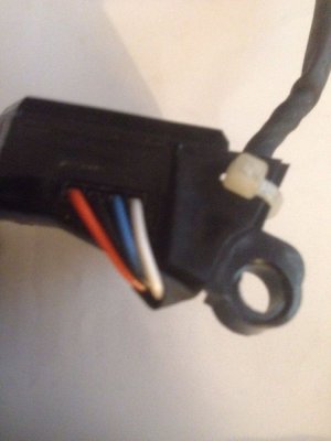

Transceiver:
There should have been a Transponder Interface connected to your transceiver wires. I would check along these wires look for a key sized box. I believe these wire go from a white four wire connect to the right of the column up to the black transceiver and ring at the cylinder. There are four thin wires wrapped in black plastic insulator those are your transceiver wires. These wires usually will not make good connections. The are only two good methods to make these connections. One is soldering the other is the snake and wrap method. Tapping into these wires can break the wires. Butt connectors rarely work well on these as the wires are to thin and the connectors can not grip them. Check theses wires for breaks and or connectors. Test the connections. Sometimes its easier to replace the transceiver assembly as the wires are very thin.
