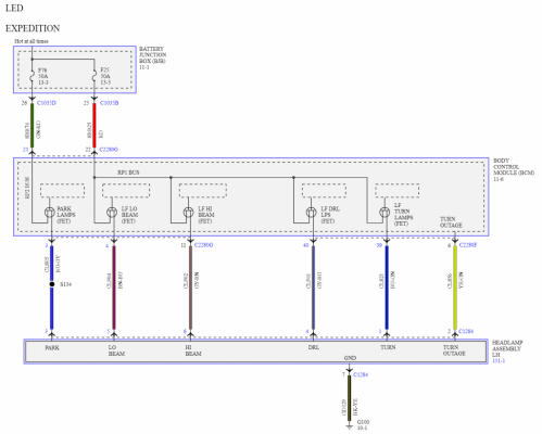

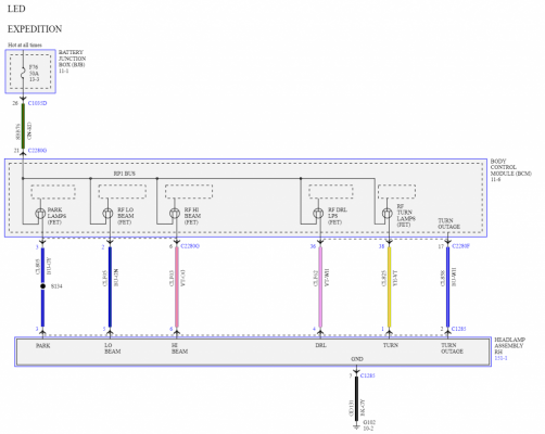

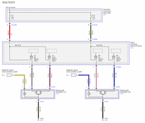

Here's the wiring diagram for a 2018 Expedition with halogen headlamps. Fuse F25 (50 amps) protects the left headlamps; fuse F76 protects the right headlamps.
There are two wiring diagrams for the 2018 with LED headlamps, one for left side (fuse F25) and one for right side (fuse F76).
In all cases, the low beam and high beam on one side are on the same fuse. If your high beams work and the low beams don't, then I'd suspect a problem in the Body Control Module (BCM) or in the communications to the BCM. The headlamp switch on the instrument panel is hardwired to the BCM. But, the steering column stalk is wired to the Steering Column Control Module which talks to the BCM over the CANbus. Note that the automatic headlamps also figure into this.

AHH, well according to the schematics, the fuses are located in the battery junction box. On my 2019, it is located near the battery.
And yet, the 2018 manual shows these for fuses 25 and 76. All this is to repeat what I said already - there are no dedicated headlight fuses. Those two fuses are for the entire BCM. Pulling them would not be advised.
As per @bb37 above - the fact the high beams work and not the low beams, indicates an issue unrelated to fuses.
