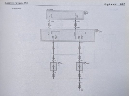

not sure what module you are talking about, but my 2019 wiring diagrams show the fog lamps are driven directly from the BCM...
I note, there's no seperate Halogen vs LED drawings for the fogs. There ARE two separate drawings for the headlights, so either all fogs are LED, or its the same wiring, they just use different lamps.
