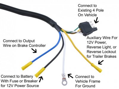

I see where the 4 pin plugs in the back in what other wires do I need to connect ?
A
Alansd
Jan 22, 2015
21
Georgia
I am thinking of going with this converter...which wires at the back do I tap?
A
Alansd
Jan 22, 2015
21
Georgia
gotcha, I got some great directions from etrailer. They show just which wires to splice . I bought a 4 way to 7 way adapter from them. They are great for hitches and all that stuff.
