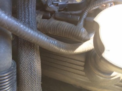

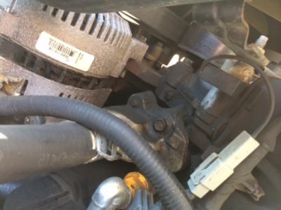

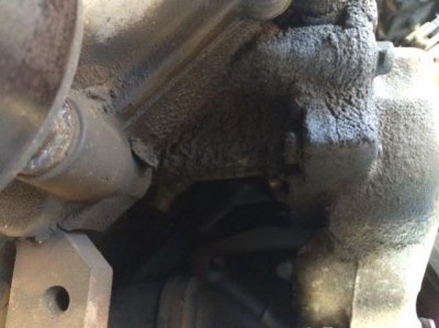

Hey guys, new to the forum here. Just bought a '00 Expy EB with the 5.4 motor and 163k miles. I noticed an oil smell under hard acceleration when I test drove the truck, but ignored it for the good deal. Now I am trying to track the source. I understand these trucks are notorious for head gasket leaks, but I can't pinpoint any oil around the heads, it's more on the pass side front, as shown in the pics below. There is some oil residue (not standing oil) in the valley between the engine, but this residue is the most concentrated in the areas pictured below (just next to the alternator) and I also get the strongest oil smell in this area. Looking from beneath the truck, I can't find any oil residue at all. Any help would be greatly appreciated!!!!

Thanks for the tip. Any ideas on what might be leaking? To be more clear, the piece in the pics that I believe to be leaking oil is on the pass side directly to the right (pass side) of the alternator with a large rubber hose pressure clamped to it. Am I way off on this being the source of the leak?

Is it possible the oil your seeing is just caked on old oil from someone carelessly putting oil in without a funnel?

All we can do is guess. The thing to do would be to clean off the caked on mess and keep an eye on it for fresh oil.

Can't see much from the pic, doesn't look wet. Try and look farther down where the exhaust manifolds attach to the heads and see if you see any signs of it being wet. Also look under truck, might be something dripping onto exhaust. And as BAD RONALD said, keep that motor away from water!

what you have in the pictures is old burned oil likely from a spill. I would not be worried in the slightest from that leak, I use the old method from my Army days, a leak is wet, a bad leak is dripping. are you sure the smell isnt coming from oil being burned inside your exhaust?
