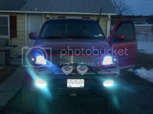

walnuts4x4
Jun 18, 2009
6,458
51
Watertown, NY
I got 10,000K HIDs in both headlights and fogs... had them for over a year now and love them... especially in the snow... look at my pic in my sig for how 10,000Ks look
