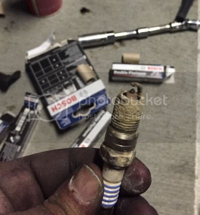

Well...after chasing all the rumble, sputter, low idle and whatever other crap I've been dealing for the last couple weeks with my new to me navigator, it just crapped out on me.
I guess this plug was the cork that was holding the damn. Lol. So the long story short went to my mechanic to see what the cel was for. Scan showed that number 8 cylinder was misfiring so after confirming that new plug and the coil was good he checked the compression and what do you know...number 8 cylinder has 0 compression. :(
DAMN!!!
Anywho not going to dump any more money in to this truck so I'm gonna dump it instead. :biggrin:
Here is the old plug as a reminder.

Might want to check next one out a little closer. Bring a scanner with ya. Do a cylinder balance test first. Some of the better scanners like snap on can do this. Sorry dude on your loss!
