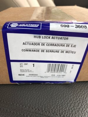

Haven’t tested that. Just randomly grinds in 2H, although it never did grind when I had it in 4x4 this last weekend. I stopped at NAPA and picked up a new one. Not sure on the quality but it is made here not Chinese.
In my experience NAPA stuff is usually pretty good. Definitely better than other parts store parts
