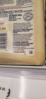

I have never been a supporter of changing oil based on time. It doesn't change it that much to sit there exposed to a little bit of air. Funny enough the way you mention all doesn't go bad on the Shelf, my son and I were at Meijer yesterday and they had recently changed their oil side to the chemical side and Kimbrel side to the other side. I don't know if they found this bottle laying behind the shelf or not but there was a bottle of Valvoline standard 5w 20. Now being 5w 20 it couldn't be that old but it was 2006 printed on the bottle.
I noticed it because it was a different bottle design than the current ones and had a white cap instead of the blue cap and it was all yellow and weathered looking. The white plastic had turned all yellow over the years. It was unopened.
I checked the UPC and the code was exactly the same as the current ones so we figured somebody must have brought it back.
I just had a Facebook tirade educating people on returns at department stores last week. Those employees don't care. If it has any sort of package and they can scan it they will give you a merchandise credit for it.
He took a picture of it. I will post it when he sends it to me.
