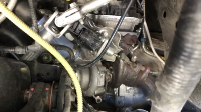

Anyone know where the turbos are located on the 3.5 ecoboost? I'm only a couple weeks into the expy, only filled it once and haven't even washed it yet.

That is under the head but looks like there is lots of room for venting the heat. My bimmer they are in the valley and not much vent flow. I think they should put them by the back bumper. Just need double the piping plus really long oil supply and return lines hopefully shielded.
