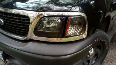

I have an '01 XLT I have already painted over all the chrome on the car with black so now the only thing left that isnt black to white is the rims. Would they look good black? And has anyone painted their stock rims black? How did it come out and what paint would you recommend?
Also her is a picture of my truck currently.

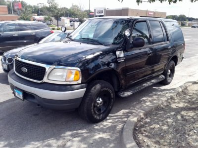

Stock 16" steelies on my 02 were the original gray. I took a wire wheel drill attachment to them and sandpaper. Then 2 coats of Rustoleum primer and 3 coats of Rustoleum satin black. Worthwhile couple hours IMO. Like anything, take your time and do it right.
