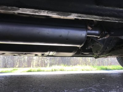

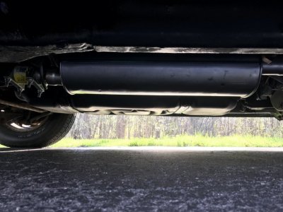

Forgot to post my muffler replacement. I cut the old one out before the bend and cut the new one in the same spot, used a 2 3/4 coupler and clamps on one side, 3 inch stainless steel bolts with stainless steel nuts with locking stars attached on the other. Also be sure to buy a new gasket. The Walker is noticeably more throaty than stock.

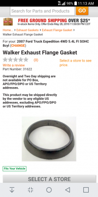

Is it a gasket or a donut? I'm not sure if it comes with the cat back so I'm going to grab one

It’s official term was a gasket, donut shaped and fat like one though. One side flat one side round.
The Exhaust looks like its made into the flange on what I ordered. It doesn't say in the instructions anything about a gasket at all. Its coming tomorrow so I'll see what it looks like. Thanks!

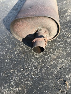

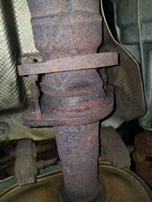

My bolts were practically needles due to rust. I ended up replacing everything with a Walker exhaust.

Were you able to get the gasket at a local parts store? Where did you buy your bolts, Home Depot?
This is the gasket. Looks like its only needed for the walker replacement.
