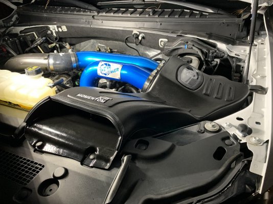

Ordered an air intake!

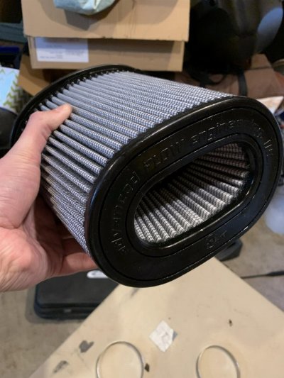

Excuse me guys for these questions.
I’ve seen many videos showing that power increase with K&N filters is around 5% (Engineering Explained), but it has significantly lower filtration capability (Project Farm).
Wouldn’t that contaminated-air damage the turbos in a boosted engine?
Plus, I see that our air intake is pretty far away from the engine, so what is the benefit of aftermarket air intake??
That REALLY is the magic question. One that @302Xplorer is trying to partially answer.
I use an AFE Dry drop in, have in all 5 of my EB powered SUV’s, and my TDI’s before that. My 2 Powerstokes before that had Volant intakes, also an after market dry media, not oiled.
Never had a single Turbo issue. My Powerstrokes both had 90,000+ miles on them, my 06 TDI had 160,000 when I traded it in on my 13 TDI, which I put 93,000 on. All of them had after market drop in filters before 10K.
I like the aftermarket media because I can clean, and put back in, less waste personally.
All of us are curious to see what the logging shows us.

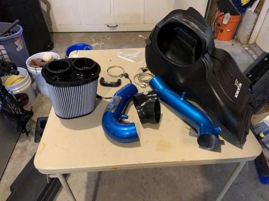

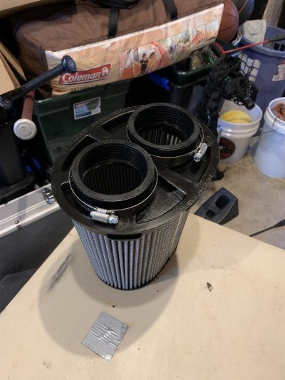

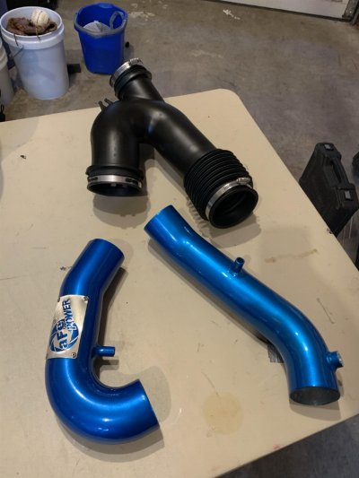

Removing the factory intake this morning!
I found something interesting; what are these things?
Do you all take them out or leave them in place?
Logically, it actually kind of makes sense. Assuming the fins produce a spiral effect in the same clockwise direction as the impeller spins, this could help reduce lag a tad. If the air is only flowing one direction without the spin, then I would think mechanically the impeller would have a little more (like milliseconds) lag. Sort of like the difference between a rolling start and a standing start. Just my hunch but maybe nothing to it.
