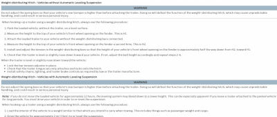

I don't think my current Expedition has the HD towing package. I just talked to the dealer and according to my VIN it has the 3.31 differential. It does fine going over to the Olympic Peninsula from Salt Lake City,across the Snake River plain in hot weather and over the Blue Mountains.
As far as load leveling, it's not clear to me that it significantly changes the weight distribution, right? So it doesn't really change the towing capacity? Don't get me wrong, I'd like to have it, but it not being available isn't a deal breaker. The HD package increases the towing capacity by 3000#, but that appears to be due to radiator and differential, not the axles, tires, etc. Also, there's more to mileage than gear ratios, so I'm hoping that going to 3.73 from 3.31 won't decrease my mileage much. I can see 20+MPG with the 3.31 final drive I have now, and 10th gear is higher than my current OD.

I'm chatting with Shannon at Ford right now and she's telling me that load leveling is standard equipment.
Oh, well, if Shannon says so, then it’s settled, lol. Just kidding.
Good information to know.

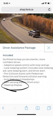

Technically the pre collision alert uses a heads up alert display.
I think you should ask Shannon to double check. If load leveling is standard equipment, Ford has managed to keep that fact well-hidden in all of their brochures and equipment descriptions. Are you sure she is not confusing load leveling with the CCD suspension?
