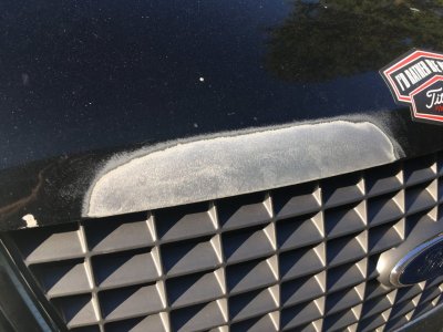

OK ... its a BEATER so I have nothing to lose and curiosity got the better of me. I random orbit 60 grit sanded the fugly area (and beyond) and this is result. Now I can drive it for a year and see what it looks like next year. No top coat. I "could" do the entire hood in about and hour, unlikely but possible - without even removing it. Sun is bright this morning. The paint area is specular reflection (mirror) and the 60 grit aluminum is very diffuse reflection so it might actually be easier on the eyes while driving into sun. I might go over one side with finer grit and polish just to extend the test case. A careful job of sanding (or blasting) specific areas might look a lot better than that paint bubbling nonsense.
BTW ... in the bright sun it has a metalflake appearance with all the component colors reflecting at the grain level. Kind of cool.
I took a followup picture of the sanded aluminum hood this morning. Still looks great, zero oxidation or corrosion after 5 months parked outside. Ok, its summer ... the real test will be winter (with salt spray). But, the bare Aluminum seems to hold up better than the bubbling paint. I'l post a picture in the spring. Hope Rusty makes it that long!
