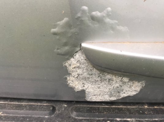

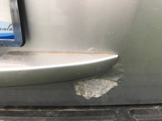

*snip*
the picture with bubbling i bet the issue started when the steal fastener was put through the alum skin and failure of a seal coating or lack thereof caused the reaction to start.
*snip*
That's no-doubt a contributor and explains why it's worse where parts are attached, but it's bubbling all over, including spots isolated from any hardware. Check the area under the glass.
Same goes for the hood on my truck. It's bubbling in places far removed from mounting hardware or damage from road debris.

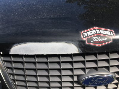

OK ... its a BEATER so I have nothing to lose and curiosity got the better of me. I random orbit 60 grit sanded the fugly area (and beyond) and this is result. Now I can drive it for a year and see what it looks like next year. No top coat. I "could" do the entire hood in about and hour, unlikely but possible - without even removing it. Sun is bright this morning. The paint area is specular reflection (mirror) and the 60 grit aluminum is very diffuse reflection so it might actually be easier on the eyes while driving into sun. I might go over one side with finer grit and polish just to extend the test case. A careful job of sanding (or blasting) specific areas might look a lot better than that paint bubbling nonsense.
BTW ... in the bright sun it has a metalflake appearance with all the component colors reflecting at the grain level. Kind of cool.
