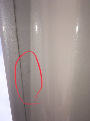

You don’t have to scratch it for it to happen. It starts occurring under the paint and shows up usually along the edges where the aluminum was bent/stressed to roll the edges over. The best theory I have heard for this is dissimilar metals/galvanic corrosion from iron contamination in the aluminum.
In fact if the paint comes off when the dealer inspects it, it is more likely to be covered. In my case the dealer when the escalated it with Ford used double sided mounding tape on a bubble. Left the backing on the one side, just a very strong tape and pulled it back with some of the paint coming off. To quote the service manager, “That’s bad but in a good way for you”
If you own a boat dissimilar metals is why you have sacrificial zincs to protect the propeller on some boats.
EDIT: Sure looks small in that image but it spreads from there. This is also a Certified Pre-Owned that was driven off the lot two weeks before we first noticed it.

Location is lip of rear liftgate. 2016 Platinum el. Luckily it’s on the interior so you can’t see itD502358D-4011-472C-BBBF-65A626000644.jpegB661F444-48AD-4057-A2E2-4DDDDDBADDAB.jpegD5543FE8-4DC1-431A-9C3C-E299CDAA3E94.jpeg
