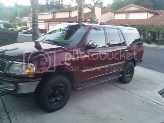

I think it will look good, I think there is a member on here with a red expi that did that, let me find the pic for you man...
Here ya go!

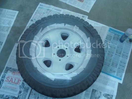

hey thats mine. yeah i did that. i did a crappy job on them kind of. heres what you need to do. watch this video http://www.youtube.com/watch?v=q5eK5OnHfqA and buy everything it asks. and hes doing it on a rim only. so if you want to paint ur rims with the tires mask off every bit of the side tire. i didnt. bad idea. heres the pics 0815091935.jpg
i only taped around the rim. so the mist of the paint went all around the tires. not a bad thing. i got new tires anyways, but if u plan to keep urs mask them off very well.
