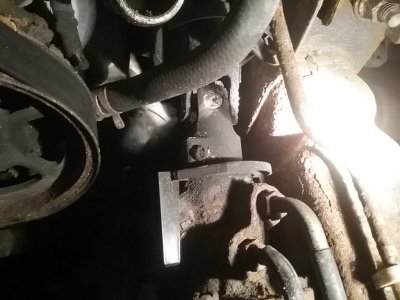

I have already replaced the steering gear and from the video below it seems like something between the steering gear and the steering rod is causing play in the wheel. Can anyone point to a specific part that would wear out and cause this?

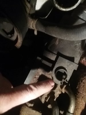

First off, to remove the plastic cover, go on top and unhook the clip from around the metal line, this will let you slide that plastic cover up the shaft,
Second, there is a u-joint under that cover, may be worn out

I would expect the steering sector inside the box is worn. The older boxes have an adjustment screw but not sure if the new boxes do.
Have someone turn the steering wheel in both directions only for the amount of play in it. Observe the steering shaft where it connects to the box. If the input shaft is turning then the play is internal.

If it is not the u-joint, then you may have to adjust the gear box.
To do this, use a 5/8 wrench to unlock the nut,by backing it off a bit, keep your wrench on the nut to prevent it from spinning with stud, insert a 3/16 allen wrench into the stud.
Tighten the stud 1/8 turn at a time while someone turns steering wheel from slack to slack, keep turning 1/8 at a time until slack is gone.
I recommend 1/8 turn at a time,for beginners, cause it is easy to over tighten stud, which will cause excess wear faster. If you done this before, then turn it as you like.
