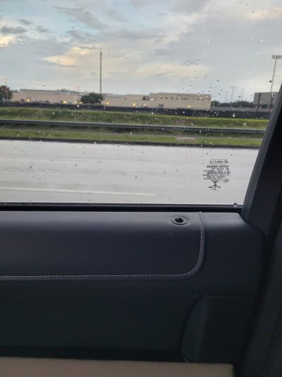

While the car was running, pushing on the trim while the door was closed caused the door to unlock and running boards to deploy. Does this mean I have an issue with my door lock?

What portion of the trim panel were you pushing on which caused the door to unlock?

I found that the top trim panel has a fair bit of play (more than the driver door). Pressing along the top near the manual button unlocked the car and deployed the running boards.
Did you buy the vehicle new? It looks as though the inner door panel has previously been removed, and not installed properly? Any warranty repairs?
Bought it new. No work was done on the vehicle. Only had the front windows tinted.
I wonder if the tint installer used a trim tool to bend back the top of the inner door panel, so the window tint would be below the glass line on the door panel - causing the issue?
