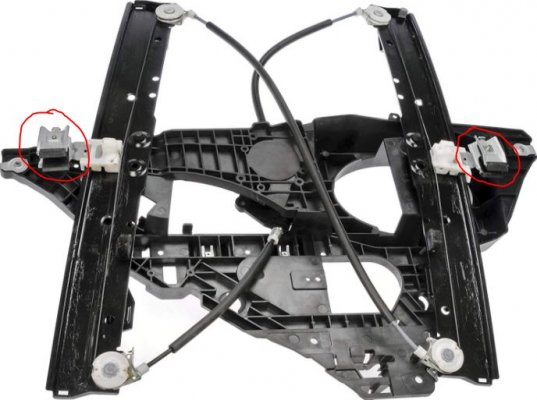

Weird, have never heard of this. The regulator has two white plastic-type holders, more like clamps, that you refer to as hinges. You slip the glass into these clamps and tighten their bolt. It sounds like your bolts have come loose? I only recall two on my '08, maybe earlier had 3?
I grabbed this image from Google. This regulator is upside down, but I circled the clamps I mention in red. The glass slips into these clamps, the rubber holds it once tightened.
Going off of memory here, you'll have to remove the door panel. Plug the power window switch back in, lower the glass about half way. There is an access hole in the door to get to one clamp, then you'll have to raise or lower it some more to get to the second one.

No rubber but some silicone that was used to hole the window in place...I need to get more silicone and look for the screws

How do you remove that assembly from the doors? I need to replace the window channel runs on my rear driver and passenger doors. However there is like a rubber nub that seems to hold that assembly to the door dead center. How do you pull it?
Take for off and lower the window all the down... take out all the screws holding the speaker housing in the doors then u can take out the screws holding it in
