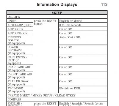

Does turning it OFF in SETUP work?
.......(not if you use MyKey)

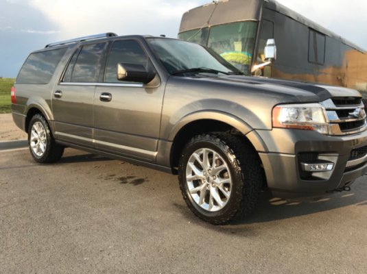

My truck is almost never gunked up. Wash it often. Still has issues. I like the beeper disable idea. Think I’ll go that route. faa8799b345ada6ce64f563d405da00d.jpg
