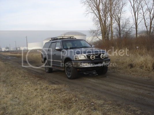

Alot..... I also have a stock 1 inch body lift it looks like...
trucks rarely loaded btw
another thing, this kit comes with brake lines... do I have to worry about half shafts and what not, or will they be fine??? I have never lifted a vehicle and have no idea what is involved....
