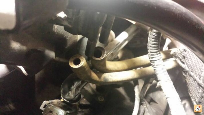

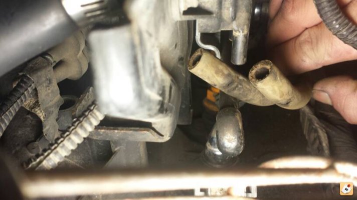

OK so I bit the bullet and started to remove the spark plugs, driver side first. As I was removing stuff to get to the plugs I was unplugging 2 small vacuum lines and I noticed that the 2 lines were cracked pretty good, could this be the reason for my 171 and 174 codes? I took acpl pics. I am going to fix those lines and finish up the spark plug job, I'll report my results after I finish.utuna7aq.jpgy4unu2y5.jpg
