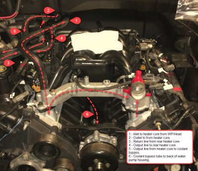

I think the one of the right is the inlet and the one on the left is the outlet. The one on the left goes down to the back of the passenger side cylinder head where the coolant bypass tube is. That runs under the intake to the back of the water pump hosing and I think that is a suction line. If you have rear AC you likely already have some T's. Yes you can add a T there (from say like a flush kit). I never had to bleed anything when I put the new motor in my truck. I filled up the degas bottle as much as possible, started the truck and kept adding coolant water mix. Temp has always been spot on. If its sealed it should pull the air out and the place you are most likely to get air is in the heater core which is the highest point.
tcwaltz
Jun 20, 2016
200
50
Niceville, FL
so I kinda put this together since there is nothing anywhere that specifically diagrams how the Expedition 5.4L works. I'm relatively sure that the water pump pushed coolant to both heads (based on the 4.6L mustang diagrams I've seen which should be able the same.) they bridge across the intake manifold to the T stat and out to the radiator. The water supply for heat comes off the passenger side. There is a T is both the supply and returns to take care of the rear. Rear return is sucked in from the bypass tube.
If anyone else things this is wrong let me know and I'll update the diagram.

Just saw that pic TC posted in a different thread and I was gonna say a picture is worth a thousand words.

Tcwaltz, start a new thread in the heating/cooling section with the pic and I'll make it a sticky.
